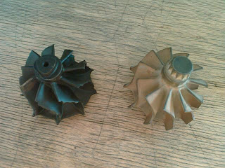

          the writing stamped into the T25 flange on the exhaust housing... thats not like that on newer garret turbos, but oem turbos did have that i think. I was just thinking to myself, "man i remember when i took my turbos off i was shocked and surprised that the exhaust wheels were NOT black... instead they had an orange tinge to them... thats because they were ceramic" have a look at this photo:
          and here ceramic on the right, steel on the left:
          thus i conclude that you sir have a turbo with a steel wheel exhaust turbine, inside a completely stock OEM garret housing.
          lastly, i think mark is probably correct, some one has rebuilt this turbo and replaced with upgraded steel wheel because theres no paint torque marks... even on mine the marks were still present.
          maybe an R32? - R33 and 34 both still had ceramic as the exhaust wheels, only N1 or upgraded versions of the car sold with steel wheel turbines.
            well i just checked and the exhaust wheel doesn't react to the magnet
              looks like your typical 32 BNR turbo.
