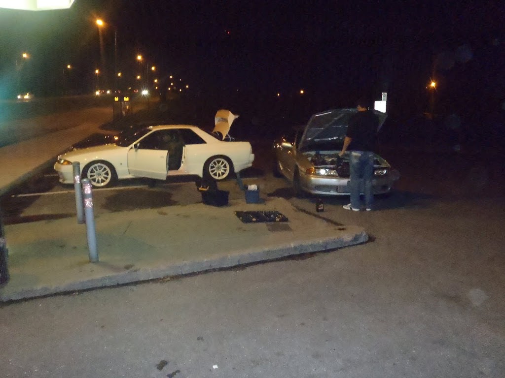

                      I was just gonna post... go ask nelsonmx about chinese oil cooler kits... beat me to it! LOL
                      gotta say though, mega props and luck for catching the oil slick on the floor before any damage was done AND he handled it like a pro for not freaking out... i would freaked! lol
