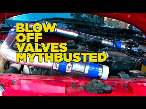

                              I run BOV less.
                              My shifts building up to boost is amazing. almost instant. LOL that's with a tiny 2L and a 3071R.
                              Mightycarmods did a vid on HP and BOV.
                              No measurable difference between none, recirc and atmospheric.
                              /thread
