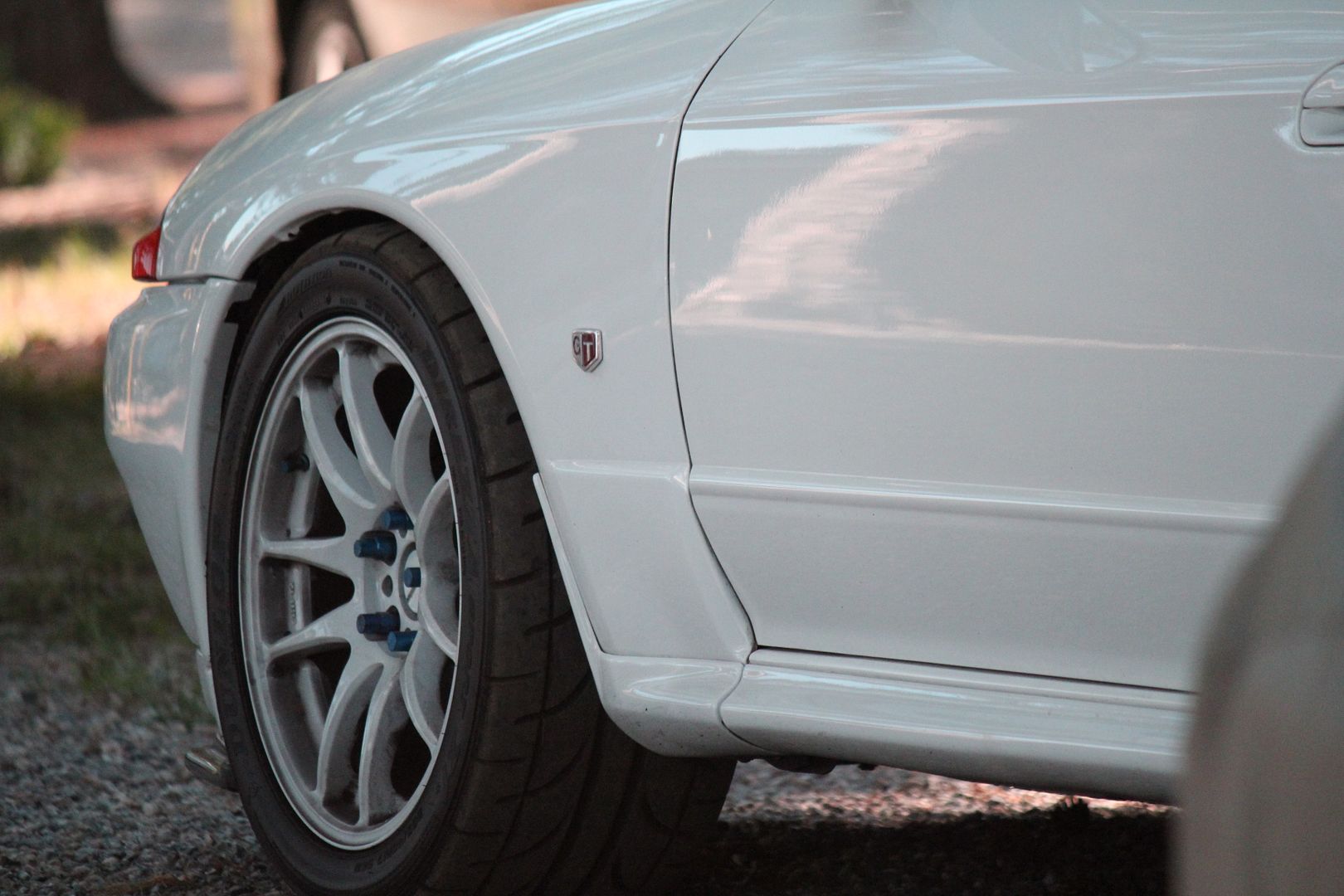

          im hopefully im the first one in bc to have xxr 527 (got it in march) 17x9.75 +25mm offset on 225/45/17 with 25mm spacer all around with no fender/panel roll or pull.....
          just set the height low enough...but i would lower .5" more for next summer...

            looks good but i agree little lower would look great
