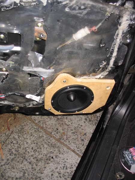

    Hey guys i have 2 6.5 JBL speakers in the rear that i wanna stick in my doors. i wannt get 2 new jbl 6.5 louder speakers for the rear. has anyone tried to fit 6.5 round speakers in the doors? im just lazy and its too cold to pull the door fenders. i realize ill need to do some modding but will they fit?
    First welcome to the forum..
    Yes you can, I have done it on my previous R32's but you will need to make a bracket for it.. I made mine out of MDF and just trimmed accordingly.

      did you manage to snag any pics of ur brackets? im going to get the stuff i need tomrrow
        No I no longer have it save on mine..
        Here is what mine looked like.. (Not my car thou)
          Taken from our friends at SAU
          Introduction
          Ok, I've just spent an hour drawing this up. So hope its useful for you guys!
          This is basically the exact plan of the spacers you will need to make up to fit either 6.5", 6", smaller, and probably larger ones, in the front doors of an R32.
          If you are *not* using 6.5" speakers (and not all 6.5" are exactly the same size), ignore the speaker cutout on the schematics, and circle in your own
          Material
          I used 16mm MDF, which allowed me to mount my 6.5" splits with a depth of 66.2mm with clearance of about 10mm - 15mm left to the window when down.
          16mm *just* allowed me to clip the doorskins back over, and pop the corner toggle in but it was very very close. To be more comfortable I'd probably go for 14mm or even 12mm MDF. But then if you go too narrow, you may have fouling issues with your window, depending on the depth of your speakers used. So you may have to find the best compromise

          This involved a lot of trial and error, and me stuffing around, so this should save you a lot of time. Simply print, cutout to size, and then trace onto your MDF.
          Get out the jigsaw, and get to work. Drill out the main screw/attach points as marked. You will need 12g screws for the mount points.. I used 12g x 30mm self tapper screws which fit fine.
          If you are using 6.5" splits, jigsaw out the center hole (I used a line of drill points to allow the jigsaw to get in there). If using another size, use the template that comes with your speakers, or make your own on paper with a compass to the correct diameter.
