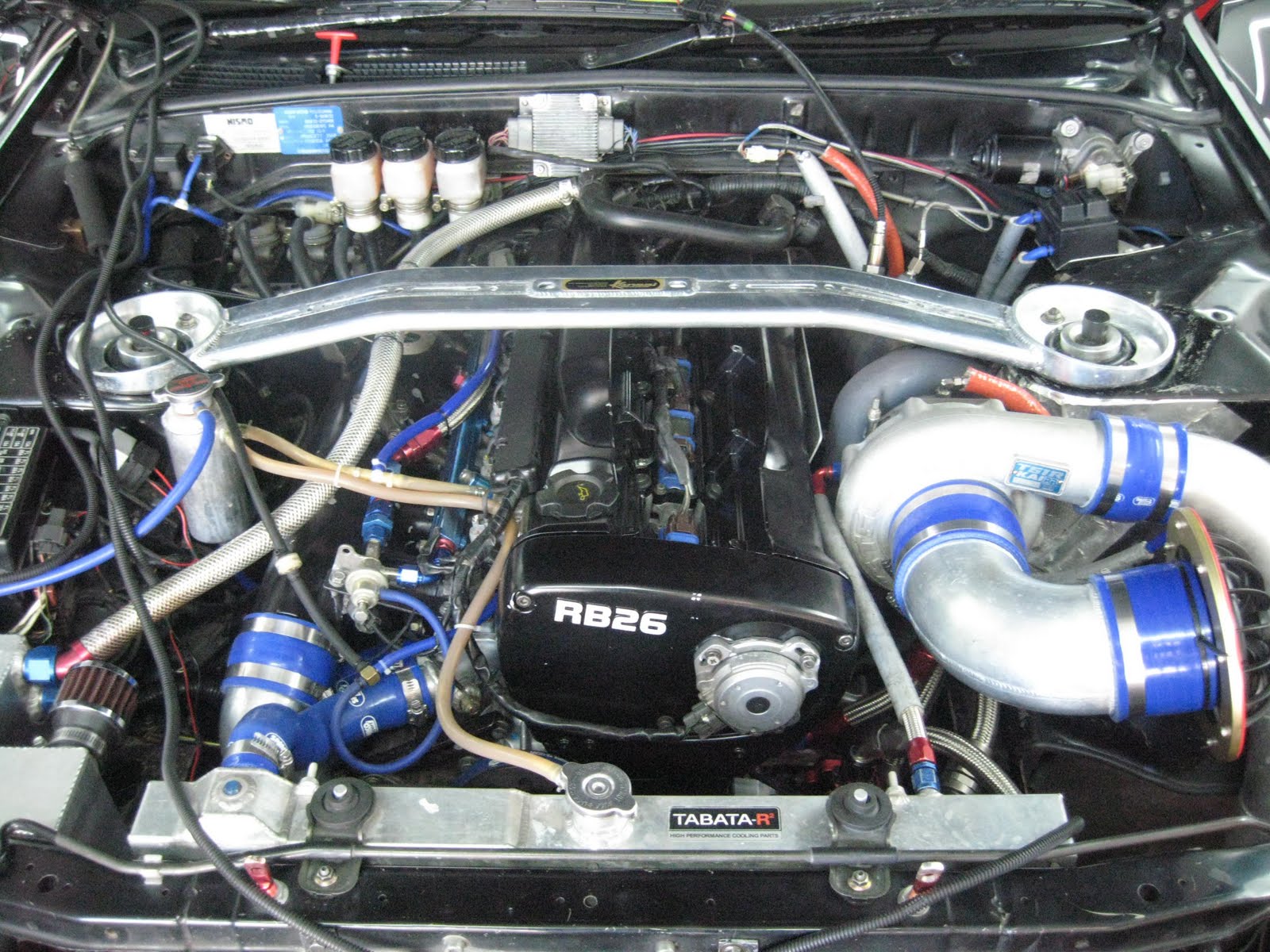

                        For Autocross you could remove brake booster, single brake master cylinder setup and run 2x aftermarket racespec brake resouvoirs, 2x brake master cylinders, etc, 1x clutch resouvoir setup, like found in engine bay on this SuperGT R32 GTR racecar -
                        Probably save some weight in the process by removing brake booster, etc.
                        I think Tilton sell the triple resouvoir setup, brake pedal assembly with master cylinders that fits inside cabin that keeps master cylinders away from engine bay heat.
