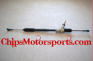

        Hi, I have toyed with the idea of making an electric Corsa column work in my R32 GTR (done it on other vehicles) but they are heavy and I'm going for as light as possible. Has anyone converted the power rack to manual properly yet (not just looped lines)? By properly I mean take the rack apart...
          see if these guys can modify an RX7 rack
          $580
          oh hai!
            Been running the oem depowered setup for almost 3 years now. (with the piston sliced). and been loving it, both on my GTST and GTR. Steering responce is much improved (even more so if you play with the preload and get rid of the rubber steering colomn coupler with an aluminum unit).
            Some effort is obviously required at low parking speeds, but other then that its only been better. The rack is heavier overall, but I didn't like how light the feel of the power rack at speed, so this is just perfect. And obviosly the cheapest (almost free) way to do it. Cost me 20$ to do mine, and that wasn't even for the rack, that was to replace the steering link bushing with aluminum.
            I wouldn't go with a "proper" manual rack anyways, yes you get less steering effort, but you loose the quick ratio of the power rack, and honestly its not that bad.

              any idea what chips does?
