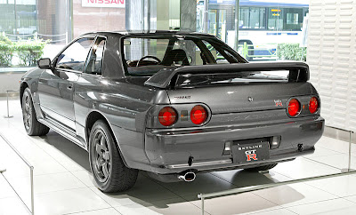

                  And I agree, stock body is just ****. What do you "hardcore skyline enthusiasts" like more;
                  This: http://www.terra2imports.ca/ab-large...3019918296.jpg
                  Or this: http://www.rhdjapan.com/images/produ...rmal/Image.jpg
                  If you say the first ones you're a fckin liar.

                    I choose the gunmetal grey BNR32 all stock with NISMO kit... but that's just me.
                      You'd be correct, that is just you.
