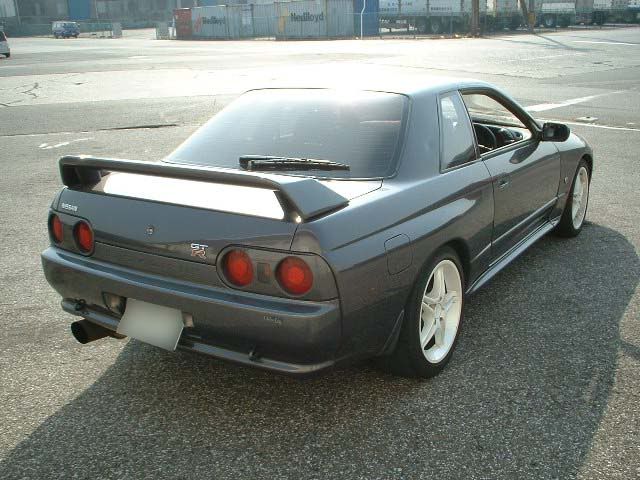

    This is how the Car used to look like
