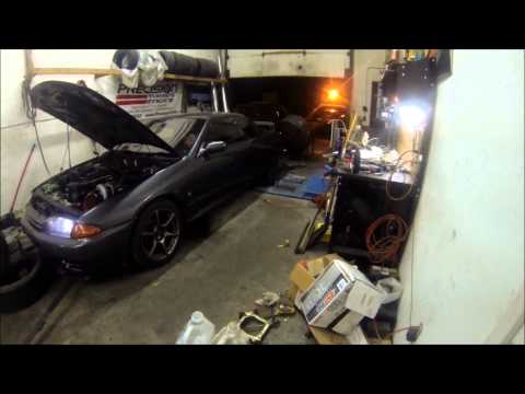

    Hey guys, i just finished my build and wanted to share with you guys what it ended up like, i did 90% of the work myself, the other 10% is dyno and downpipe, as i do not have a stainless steel welder. Enjoy!

                    everything is in the video!
                      Ah ok, so 600whp on water/meth @ 23 psi, how much on pump @ 17psi?
                        570 @17 psi
                          Any idea why you only made another 30-40hp with an extra 6psi of boost and meth? Doesn't seem quite right. Those are real good numbers for pump gas and 17psi though. Must be a healthy motor.
                            The motor went through a 100% rebuild, and im really not someone who will cut a corner. My tuner said per psi of boost you can pull out 8-15 wheel horse power. So 570 @ 17 psi add up 6 psi of boost the numbers add up pretty right.
