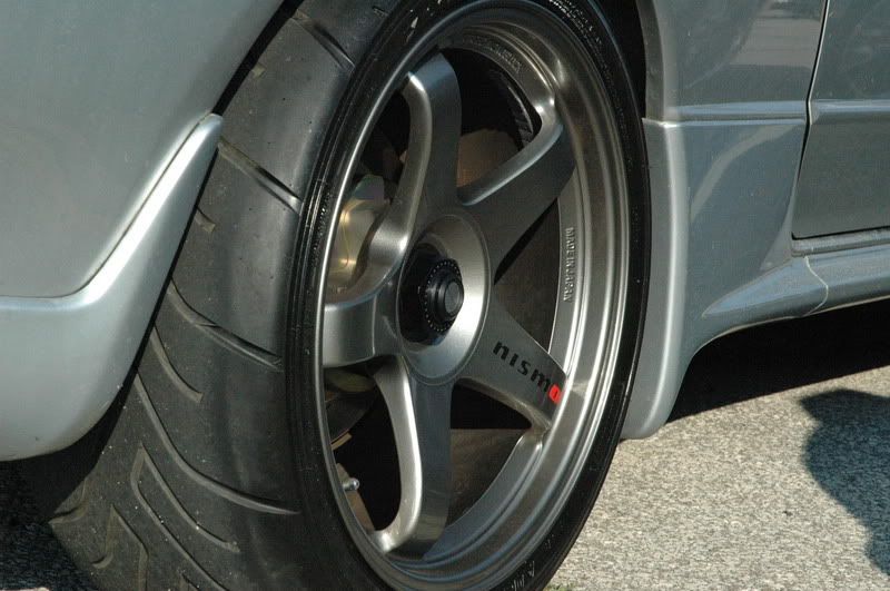

      I've ran Advan RGs 18x9.5 +12 offset with no real issues... you'll get some rubbing in the front inner wheel well when you make sharp turns but it doesn't bother me... rolled fenders recommended!!!

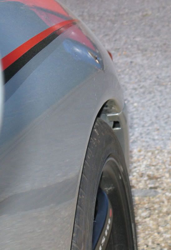

        This is the wheel and offset next on my list after a new transmission next month.If you run -3.5 degrees camber on the front you could actually go out a bit more.The rear is tight with no camber.
        These are harvey's lmgt4's 18 x 9.5 12 et
        I have 18 x 9.5 22 et and they could easily come out 10 more mm.Go for it Daryl!What wheels are you looking at anyway?

          it looks like it will be really close in the back then. the back is what concerns me the most.

                  Front

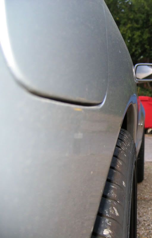

                  back

                      back
                      This is what worries me, my rear wheels need to tuck because my car is much lower then that picture. I just hope that the negative camber will allow them to tuck. On my old Accord I had improper offset wheels, and they tucked with literally a paper thin buffer. Perhaps I'll try that again lol.

                          Ok... My personal experience..... I never have any rubbing issues in the back. My rear fenders are unrolled. The fronts like GTR said.. has a lil of rubbing on the inner fenders when you turn the wheels at the extreme angles. Not really a big deal to me either. But when I hit a big bump (very rarely only on some bad toronto roads) the tires rub a lil on one my the fender liner bolt(I think it is the second on from the front). I would run a lil more camber to solve the problem since aluminum fenders are bitch to roll. Hope this helps. Btw, My tires are 265/35/18 A048s all around. Very meaty tires.
