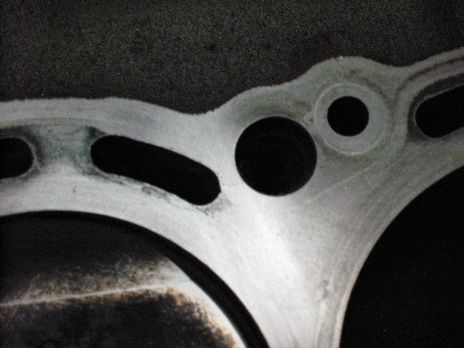

              From what I understand, headgasket commonly fails on 5th, 6th cylinder, as they are closest to firewall and the result is those cylinders get the hottest and head warps. More so if the cylinders run lean. Shortblock can crack around those cylinders if it gets hot enough. So clean the deck of shortblock and look for cracks. Cracks look like this -
              Nismo bore out the watergallery's in N1 shortblock, N1 head to help solve this heat build up / cracking problem. It's a common problem with straight 6 engines.
              The dude from Japan in this link with RB26, did the bore out of watergallery's mod around 5th, 6th cylinder with stock shortblock and it helped to solve the heat problem -

                Any way to check the block while in the car?? I really don't want to pull the whole thing

                      Check the head for sure!! Should I be ok with just that?? I will check for a crack in the block after I clean it up, or do you think I still need to pull it!!:-(

                              nope, just as you are cleaning the block check it closely. you could even magnaflux in the engine bay it if you really wanted.

                                Just clean/check the deck of shortblock for cracks. If no cracks, don't need a new/second hand shortblock. In somecases it's easier to bin engine and fit another low km second hand stock engine (replace headgasket) or new N1 engine with N1 shortblock, etc. With N1 engine option, all the sensors, etc are new and has the watergallery, etc mods and raises value of car. But it's not cheap. Also any shortblock can crack if engine is not left too cool before flushing cooling system.
