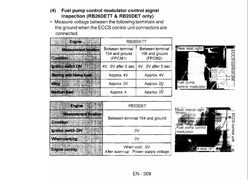

If your coils are weak or if the spark is not strong enough, you would have sputter. But I am leaning more towards your fuel side. Glad you got the MAF ok. What is the situation with your fuel pump? Is it possible for you to flow test your injectors or replace them with different ones to see if anything changes?
