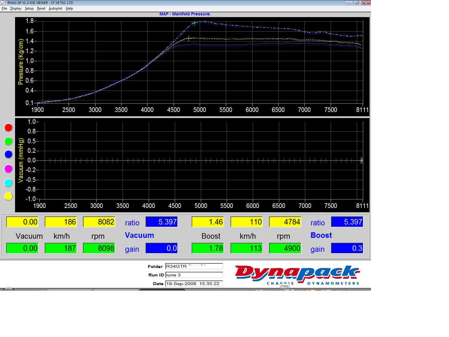

              Boost graph -
              Can see the boost drop off at higher rpm's (running out of puff). It could be due to small A/R exhaust housings. Supposedly if ran higher octane gas (only running 98 octane pump gas), can extract more hp (I gather due to running more ignition timing with higher octane gas). Note engine is being reved slightly above 8000rpm.
