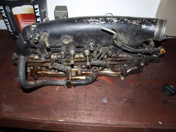

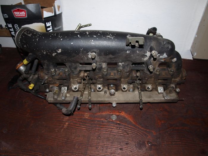

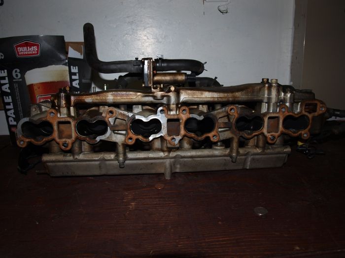

                    This might help.
                    Upside down but you can see here all the bolts you need to remove.
                    remove bolts, leave a couple in loose and with a hammer just give it a tap or two. should come loose without much effort.
                    Leaving a couple bolts in place will just let it come loose and anything that's caught in it wont fall and get swallowed by some crevice
