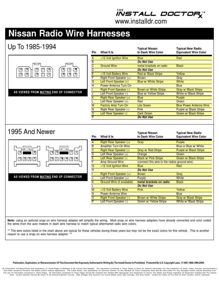

Oem stereo wiring harness
  • Oem stereo wiring harness
    Anyone have a diagram of which wire is which? I'd rather not go w/ a power connector or whatever their name is and figure it all out.
    I had my old stereo professionally done. I'd like to save some cash this time
    Thanks!
    Originally posted by Robski
    do you really want something a guy with a Civic has?
    google is always the best way to get started...
    Nissan in dash wire Harnesses Up to 1985-1994 Pin A B C D E F G H I J K L M N O P What It Is +12 Volt Ignition Wire Ground Wire +12 Vdc Battery wire Power Antenna Turn On Right Front Speaker (+) Left Front Speaker (-) Left Rear Speaker (+) Factory Amp Turn On Right Rear Speaker (-), Left Rear Speaker (-) Right Rear Speaker (+) Power Antenna wire Right Rear Speaker
    Toy: BNR32
    DD: R50
      This isn't the same wiring as my car. That picture is all over google. I can't find anything that matches my car. My car has a **** ton of colours different from them, and some twisted together which I'd assume would be the speaker wire till I found out theres 6 sets of them.
      Originally posted by Robski
      do you really want something a guy with a Civic has?
