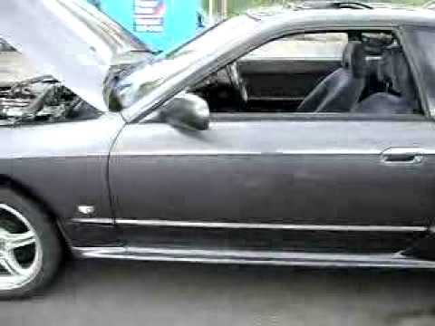

                      i will post a video of my gts-t back in the day with air bag, i just took a look at the video it appears to be the same wheel as in a s2 r33... strangeee
