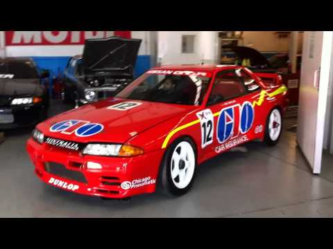

    Side swept Group-A exhaust would sound better and give better turbo spool -

                          This is another non screamer Group-A sound (sounds better with RB20DET) -
