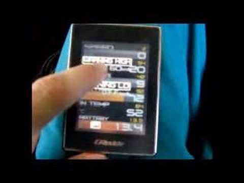

            If was me, I would run HKS camp (takes up less room than gauges and cheaper than a set of gauges, have more options as far as digital gauges go) -
            Or run Greedy Informeter Touch with additional sensor options for oil temp, oil pressure, etc (takes up less room) -
            Greedy Informeter on R32 GTR -
              ^^^ Informeter FTW! I run one in my GTR and love it.
