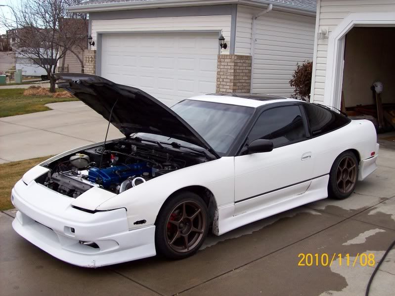

Hey guys , not really much of a build thread but i thought this place would be best to post so dont flame.
Here is my 92 240sx. RB20 swap.
I Rebuilt the RB20 myself focusing on making it a strong as possible with the lowest amount of money. I've done my research, learnt a few things along the way and this is the outcome.
Rebuilt motor >5000k ( All new gaskets and seals )
Micro-Polished Crank
Stock Pistons ( Had tops ceramic coated and skirts dry filmed )
Stock Connecting Rods
ARP Connecting Rod Bolts
ARP Main Studs
ACL Connecting Rod Bearing
ACL Main Bearings
ARP Head Studs
Tomei 1.2mm Headgasket
Ported & Polished Head
Cometic Intake Manifold Gasket
KU Engineering Intake Manifold
Q45 Throttle Body
N1 Water Pump
Aeromotive Fuel Pressure Regulator
RB25 Turbo ( 12psi , keeping it safe )
Greddy Profec B SpecII
ACT Street Disk Clutch
ACT Heavy Duty Pressure Plate
12Ibs Flywheel
3" Megan Downpipe
3" Megan Testpipe
3" Exhaust
Megan Front Mount Intercooler
Mishimoto Radiator
2x 12" Electric Fans
... thats about it .. i think , engine wise atleast.
Still have some plans in the making for this car so keep in mind this is not a 100% complete project.
