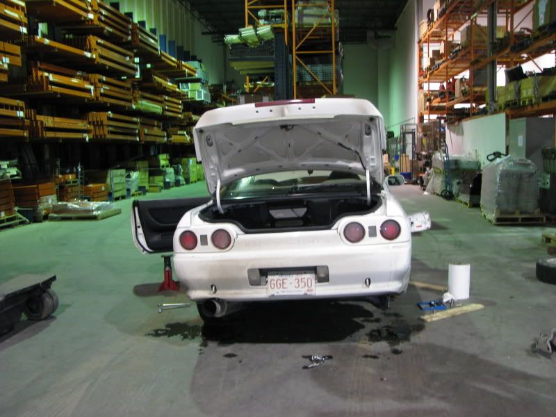

1. Jack up rear end of vehicle, I only jacked up the driver side.

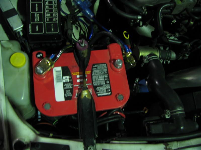

**Disconnect battery** any sparks can be potentially deadly.

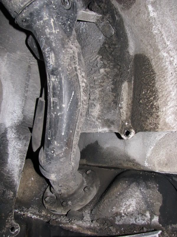

2. Remove Driver side wheel, will need to access driver side clamp, and remove the plastic cowling.
-note bolt at the top of the filler arm needs to be removed, rear plastic valence is removable and will just drop out.

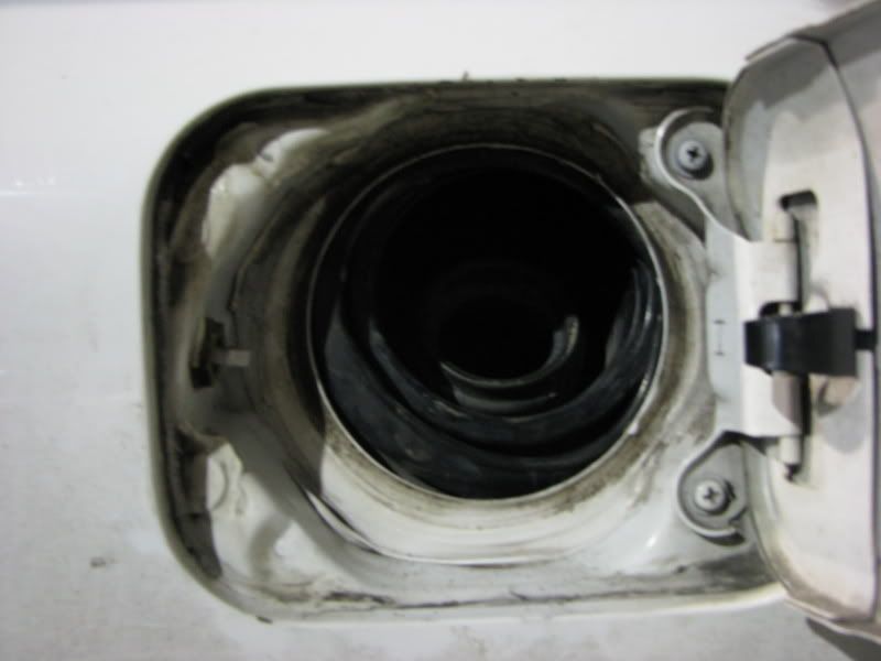

3. to disconnect from fuel door, simply press the plastic seal off and into the body of the vehicle. Re-install is the same way, should be very easy to do.

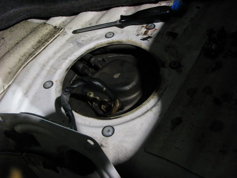

4. Remove fuel pump. As Per Fuel pump DIY. Remove both cover plates, remove all pump bolts, slide pump back, remove both lines, and pull out.

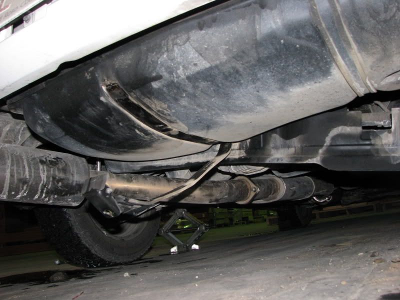

5. Remove Passenger side strap. (rear bolt) Then remove driver side via rear wheel well. front bolt is easiest to get at and remove. An impact, or air ratchet is very handy, these bolts have a lot of stress on them.
** Be sure to support tank, when these bolts are removed tank will simply drop out.

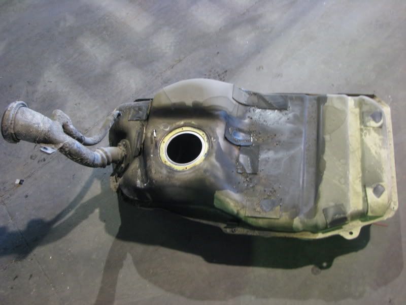

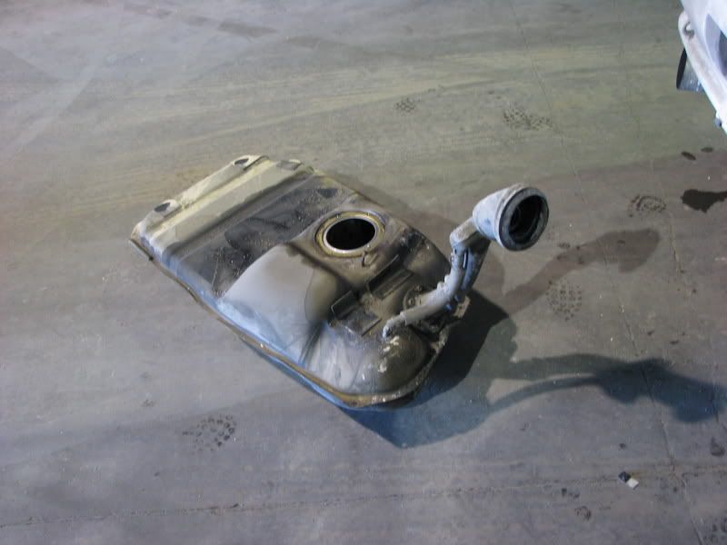

-I used a pallet jack because i had one available, When tank is free lower it slowly, and remove the third line that goes to the tank.

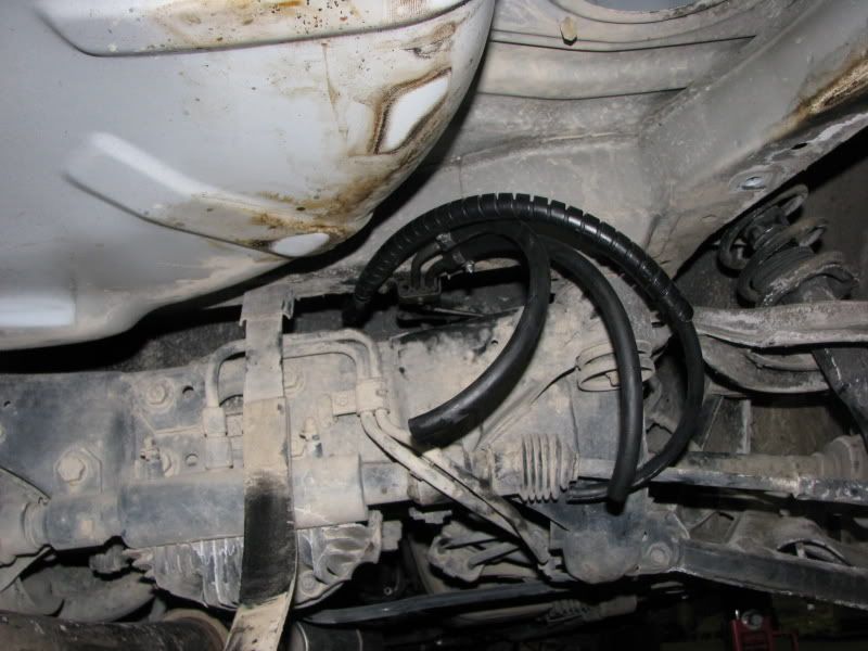

6. Wash and or rinse out tank. Remove filler arm, and reseal. Its a good idea to replace all fuel lines. ONLY the 2 going to the fuel pump are high pressure, the third is a low pressure line, and only needs gas resistant hose.
I purchased mine at Napa for ~30$ with 6 proper hose clamps. My low pressure line was cut and leaking. both high pressure lines were very brittle, and beginning to crack.
