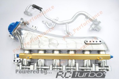

    Plenums won't fit unfortunately. If they would fit ou would see many 20 guys running the affordable the front facing greddy that is made for the 25. Injectors I believe would difference because the 20's are top feed and the 25's are side feed. One way to take care of that though would be to grab rb26 injectors and resistor pack and then later on you can just upgrade to bigger top feeds which have more potential in the hp area. I have seen side feed injectors top off at 1100 cc injectors and top feed are easily available for pricing at a higher range. I personally ran a 25 with rb26 injectors and modded rail to fit the 25 plenum. Great investment if you want big power!

                u can buy just the front facing "plenum" only that bolts to your stock intake mani for the RB20DET on ebay..theyre around 300.00+ shipping .. ive read reviews and suppose they work pretty good and are pretty straight no crookedness in the aluminium

                    Thanks for that! the reason I'm going to FF plenum is to keep lag down as much as possible as my fmic isn't a turnkey. So are the Nismo and N1 pumps different and if so, is my assumption that the Nismo is better correct?
                    @Trickey, are you talking about the GSP "plenums" without runners in them like the one in the link?
                    Honestly, I'd rather spend a bit more cash and get one that has the runners in it like this:
                    Find many great new & used options and get the best deals for RB20DET Skyline RB20 intake manifold 90mm TB+ fuel rail at the best online prices at eBay! Free shipping for many products!
                    For a G you get a nicer plenum with runners inside, the water line, 90mm TB, and fuel rail. I think it's a better deal but I don't know really
