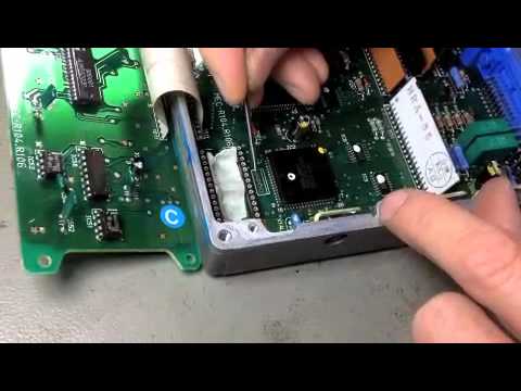

                    If stock ECU is chipped it should have a 28 pin EPROM socket installed, so remove 28 pin EPROM chip and fit Nistune board (has stock maps on it) into 28 pin socket. Then solder cable into main circuit board and connect plug to Nistune board.
                    Here's how Nistune board is installed -
