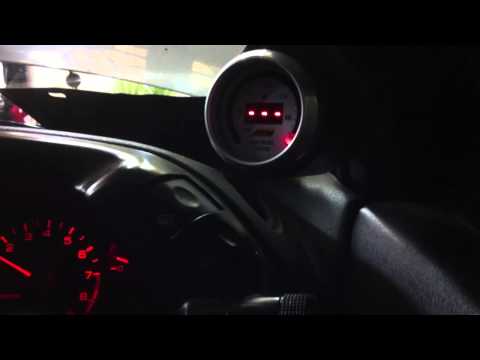

    3.)aac plugged in and unplugged the issue is erratic, some times the car will idle fine and then others it will idle horribly (ive attached a video of whats going on)
