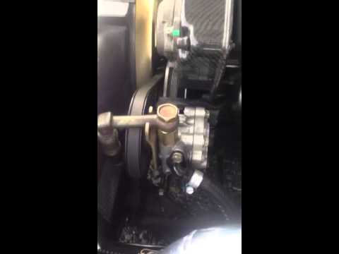

    think it must be a bearing of some sort just sounds like a rough turning idler or something any ideas?

    have you checked your powersteering fluid level. mine kinda of sounded like that when it was right empty from deleting hicas

      No I haven't, which reservoir is that?

        the one on the passanger side of the engine bay with wires coming out of the cap.

          yea tiny bit low, do the bearings or something go bad in them as mine is sounding ugly... it was a tiny low but i mean a tiny, not enough to make as much noise as it is.

            Powersteering pump pully bearing does fail on the front. Happened to my mates R32. It sounded like it was coming from the cambelt cover. Get a mechanics stethoscope and check just behind powersteering pump pully to confirm.

              Take the belt off a retest it.

                ..... why the eff didnt i think of doing this? so simple haha, thanks will do tonight!
