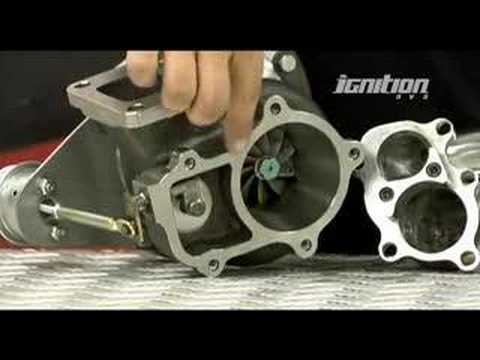

    Here is the rear of the turbo I find it odd the waste gate is kinda blocked off compared to stock turbine housing and has to flow down at a 90 degree angle to the down pipe.
    Does it seem this turbo is wrong for my car and now with cams and thicker head gasket I'm out flowing it? Can I try heavier waste gate spring or is there a controller setup that can hold the boost consistent?
    That's normal for RB25DET, RB30DET engines when they create more exhaust gas.
    With boost spike the internal wastegate is too slow to react / open the wastegate flap on the back of the turbo hence the wastegate opens slowly and not enough to dump enough exhaust gas in the exhaust housing, which is still driving the exhaust wheel and you get a boost spike. It's common with internal wastegates (they have their limits).
    Most boost controllers have a map sensor that can detect and reduce this boost spike (can drop the boost level by opening the wastegate way before it reaches peak boost). HKS EVC is one boost controller that has this feature and I think Blitz boost controller does as well. Apexi has boost level in each gear to gain maximum traction (good for drag racing).
    The answer is to bore out the existing wastegate hole on the exhaust housing and fit a bigger wastegate flap to make it vent more exhaust gas or upgrade to an external wastegate with a bigger diameter hole, etc.
    Another option is to change the exhaust housing to one that has a bigger flap.

      That explains my problem I'll just keep it at wastegate pressure for now. The turbo really just seems to be steel wheel'ed stock replacement and probably isn't suited to the cams and thicker headgasket.
