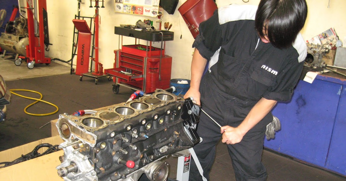

This is a RB26 engine with 737awhp and was done properly, which lasted 2 years (routine check / rebuild) -
550kw over at wheel, abused for 2years.........this R32GTR engine is now time to open....Nothing major things happened, but it's overhaul ti...
Note the bearings are on the way out (common problem with wetsump setup). Dry sump should help to extend the lifespan of bearings, etc, but not everyone can afford a drysump setup.Last edited by Skym; 04-19-2012, 03:53 AM.RESPONSE MONSTER
