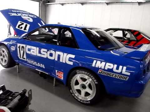

              Racecar -
              Airjacks to raise car off ground and warm engine up.
              Then put into gear, spin wheels to warmup diffhead, gearbox, etc.
              Drive on racetrack for 1 lap (warmup lap), then thrash it the next lap.
              Warming engine up on airjacks -
