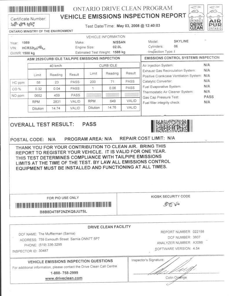

                        This is what my car passed with(at least the stuff that may effect emmsions), well below the "limits". I posted a scan of m results below:
                        Stinky tune Spec 4
                        NEW o2 (300ZX TT)
                        Coils in spec (.8 ohms IF I remember right)
                        New plugs NGK Iridium BCPR6EIX gapped @ .9
                        Timing @ OEM spec
                        94 Sunoco
                        255lph fuel pump
                        CAT in place
                        3" Apexi Cat-back
                        Boost @ 12psi
                        HKS mushroom intake
                        Cleaned AAC valve
                        MAKE SURE NO BOOST LEAKS, as this would cause a rich mixture also.
                        A hotter CAT works better so a good 20-30 min on the highway is good..
                        If all else fails I would suggest a compression test as a last resort, make sure everything is ok in there..
                        Hope this all helps..
