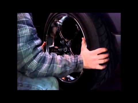

                              soo i think its a combination of the pads definitely hitting the calipers like Voodo said im not sure how to go about fixing this.. theyre actually new calipers that had all new clips etc. its like the pad is a couple mm to small. you can see where the pad has been hitting the caliper in the pics
                              and like Marc said the drivetrain seems super sloppy.. they're is no way this is within spec. also notice, with the e-brake on i can still move the wheel a tiny bit and then the brake locks it( and its the rotor moving in the pads. pads aren't moving)
