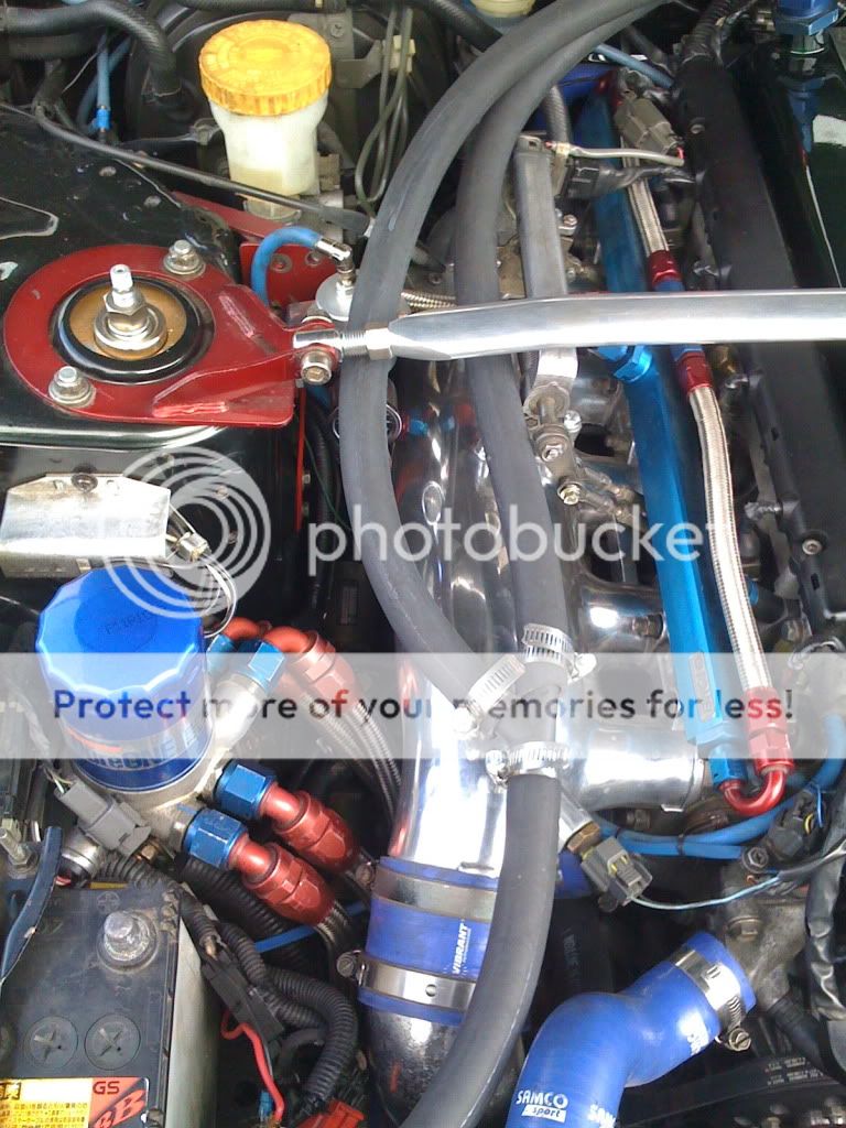

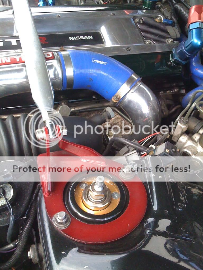

    copy and pasted from sr20gt30r's thread on gtrpwr.com

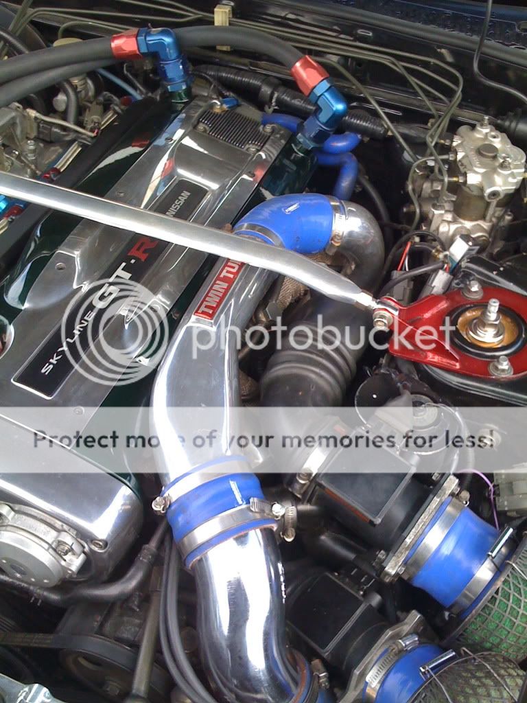

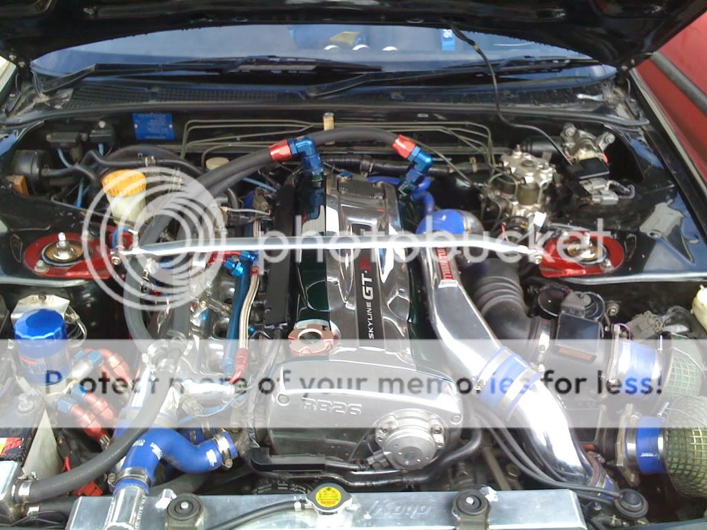

    VEHICLE:BNR32 1990
    ENGINE:RB26DETT stroked HKS 2.8L (2795cc)with new N1 block
    MILEAGE:110,000km on body and 5,000km on motor
    OIL/WATER PUMP:both N1 with ATI race damper
    OILING SYSTEM:Greddy 13 row cooler
    INJECTORS:1000cc RC engineering
    FUEL SYSTEM: only a tomei 280lph
    TURBO SETUP: twin gt2860-5 , stock manifolds ported and wraped, HKS dump pipes
    MAP or MAF's: apexi MAP sensors
    INTAKE SETUP: twin custom intakes, HKS filters pods, Nismo intake plenum
    INTERCOOLER: HKS 100mm x 600mm x 300mm, HKS hard piping, OEM Y pipe upgraded (PM me if you want to know more about;-) )
    VALVETRAIN: Greddy easy cams set 264 deg.
    HEAD WORK:squirt area removed(4cc + per cylinder), ported
    EXHAUST:Greddy mx downpipe, catless, HKS 4" exhaust
    BOOST LEVEL:21 psi
    ECU SETUP:Apexi PowerFC D-Jetro with datalogit
    CLUTCH: OS Giken R3C
    DRIVETRAIN F/R:Nismo GT rear diff., PPG 1-4 DOG gearset
    SPECIAL NOTES: 94 octane, 32 °C outside with 75% humidity!!
    DYNO:Almassi Tuning (Delson, Quebec)
    HP:632WHP (740hp estimated at flywheel)
    TQ:589 lb/ft
    ran 10.07@136mph , 1.4sec 0-60ft
    VIDEOS:
    PICS:

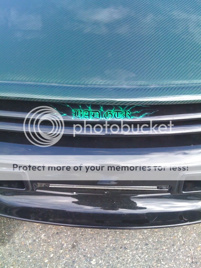

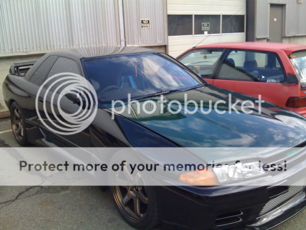

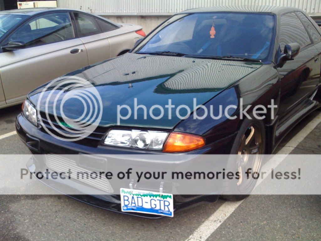

                    i just came across a gtr today with the plates badgtr,
                    Gorgeous car. 580AWHP. I bet it's pretty quick lol
