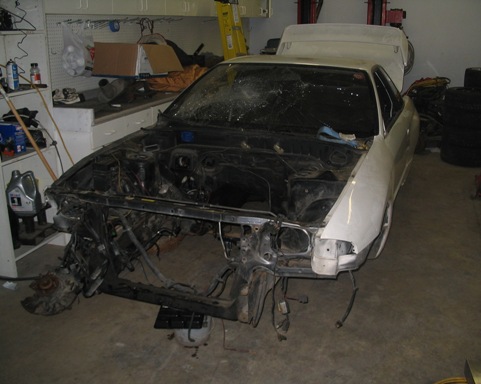

          lets see some pics of the stripped GTR!!!
          91 GTR - 04 G35c - 91 celica.....
            As found next to a dumpster...
            Tucked away getting ready for a roll cage
            Had some interior pictures, completely stripped inside, wiring harness removed, dash, HVAC, peddles, steering column, seats, carpet, etc. Can't seem to find them, will have to take some more.

              "As found by the dumpster"..........Bwahahahaha!!!!!
              That's awesome, it just goes to show how far we have come in Canada with Skylines that you can find suff like that behind someone's bussiness. Keep rockin' it.
