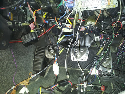

I believe the car's been through some hell, some kids just beat up on it and put underbody lights on it, as well as some shoddy electrical work. This is my 'rescue ride' of sorts. I'm looking to do a smooth and steady clean build, and will try to detail it on these. I'll admit to being new to this, so comments and critiques are welcome.
