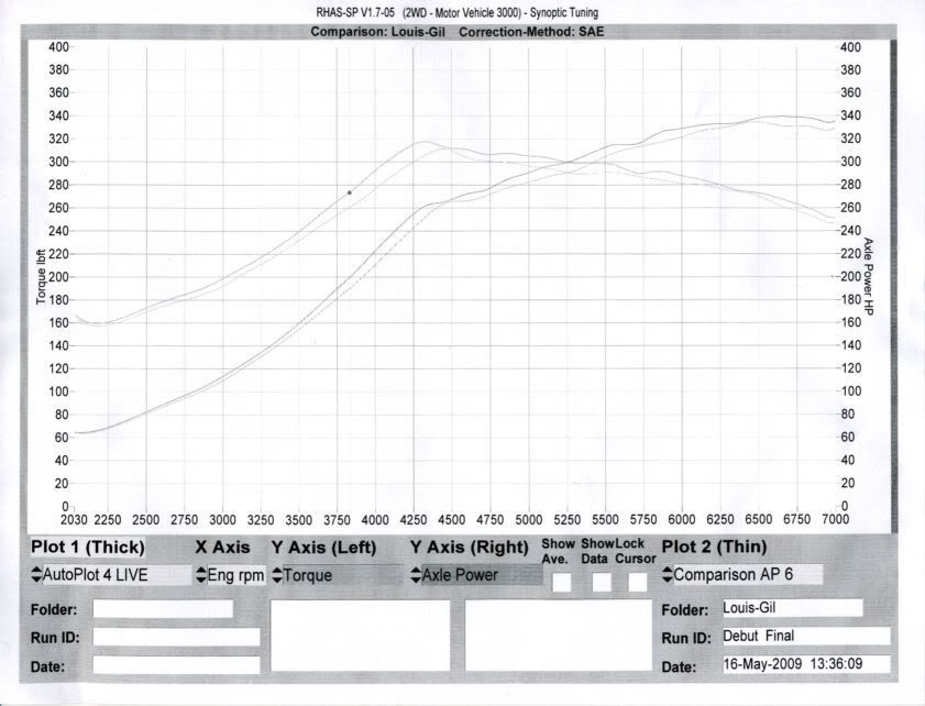

                I directly tested on the dyno twin turbo pipe divided.
                13.5psi stock turbo with intake and exhaust.
                The white lines are with the twin pipe stock.
                I had a miss fire at the very end of session, said that its dark line of 5700 & 6350 RPM is a slight decrease.
                I had a 7HP gain and above 9 lbs / torque 200 rpm faster.
                Total, 340 whp, 320 lbs / torque.
                [IMG][/IMG]
