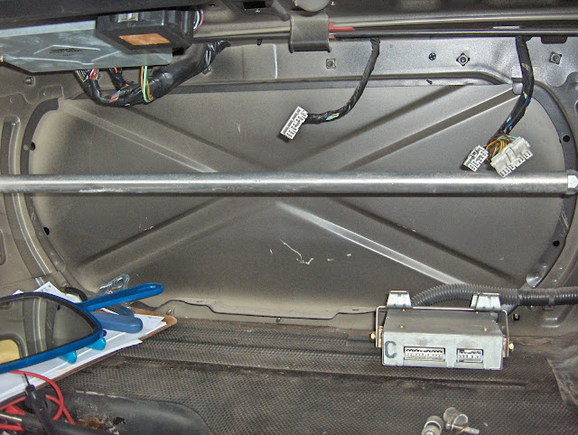

            where is the awd ecu on the left side of the trunk? people around town said some dude that worked on my car stole some **** when they did it before i owned it, do u have a pic of the awd ecu?

              Here u see on the left silver box there is like a clear eye on it we don't see on the pic u will get flashing red light u count how many time it flash to get the code.
                the one up top on the left ??? ill go take a look now.

                  ok just looked at mine has some wires pulled out of it pics to come shortly where in nb are you leking

                      ok so the wires that arent connected are yellow red green and black, any ideas where they go??? attaching a pic hard to see though
