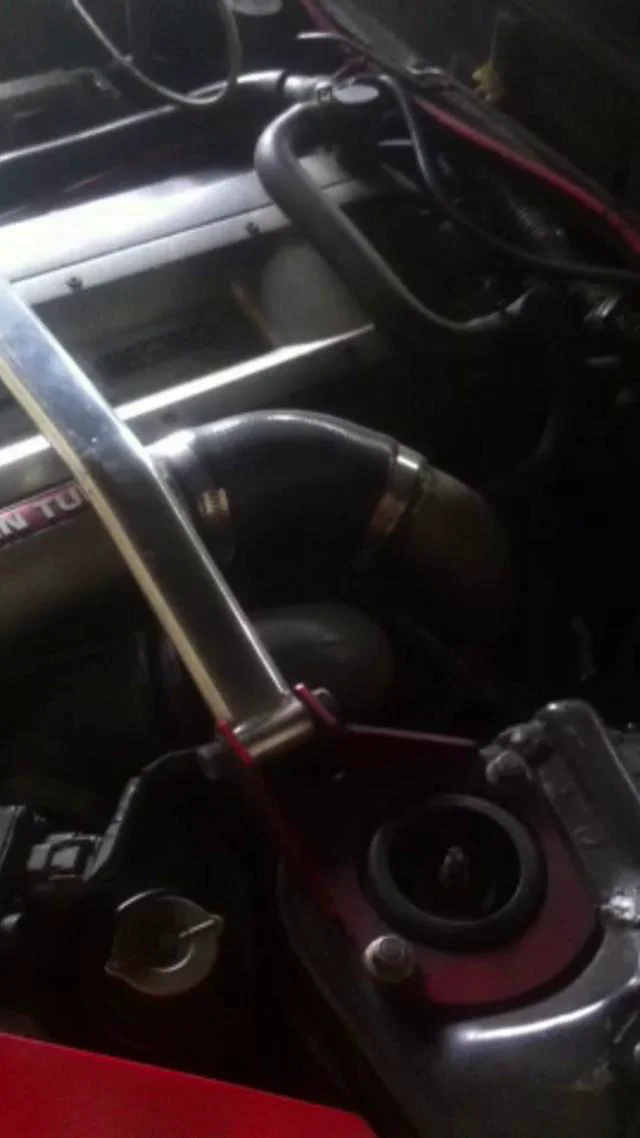

Hey looking for some input on what might be wrong. Drove from Kelowna to Penticton today and back ( drove it hard in places ) had no issues until i was almost home. Drove up to a light everything was all good before getting there. Sat at the light waiting for it to change, light changed drove away and this is where the issue started. Car had a totally different sound to it. Hard to describe, almost like a Subaru with an a/m exhaust on it. I didn't even think about boosting the car once it started making this sound. Luckily I was really close to come. No idea where to even begin diagnosing this. I'll post up a video of it because I really don't know how to describe it.
R32 Nismo GTR engine

Motor doesn't shake at all. It sounds like it's coming from the exhaust side of the engine by the rear turbo. The exhaust sounds like its misfiring at but idle but i've never heard a car sound like this just from a miss fire. I'll check my plugs, coils, injectors and intercooler pipes tomorrow morning and see if i can't find something there. I'll get a better video of the problem tomorrow morning (the one I took sucks) as well if none of the above solves it.
