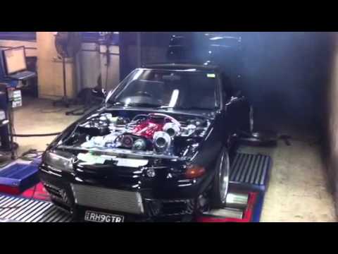

    So as some might know, I spent this last evening at my local drag strip. After having three pretty decent runs of 11.7s / 11.8s / 12.0s, I let my car relax for a few runs and on the fourth run, (which was looking very promising to break my goal of 11.5) I blew third gear.
    Really nice launch and smooth roll out of the clutch with minimal wheel spin, bang into 2nd and I guess I just shifted way too fast into third because as soon as I dumped the clutch it felt like all of third completely sheared smooth. I still have a fully working 1st 2nd 4th & 5th and drove the car home approx 50kms after the night.
    I can litterally sit at idle or any rpms for that matter and put the car into and out of third gear without the clutch engaged!
    It sounds like all the bits from the third gear are rattling around in the gearbox, I don't know a whole lot about gearbox's so I'm not entirely sure what really could have happened but I will find out when I open it up. In the meantime, I've already found another transmission that I'm buying in a day or two to replace this one.
    I'm posting this mainly because I'd like some opinions on what my options are here. Ill be clear now, I'm not a typical drag junkie, I only like to run a couple times a year so I will NOT be looking at PPG, Hollinger, or OSG. I cannot do the 5k+ for a transmission right now. From now on I'm going to slow my shifts a bit to give the tranny a break on the track, I'm really lucky I didn't do any worse damage other than just a gear.
    So any suggestions? Any price quotes you might know of? Post your info please!!
    For reference, the cars making 500whp planted with a nismo super coppermix twin plate.

                  wow sick car well built twins for life..
                    how much boost that beast sipping on..
                      Depends heavily on the hairdrier, look at my Sig...that's only 17 psi of blow.
