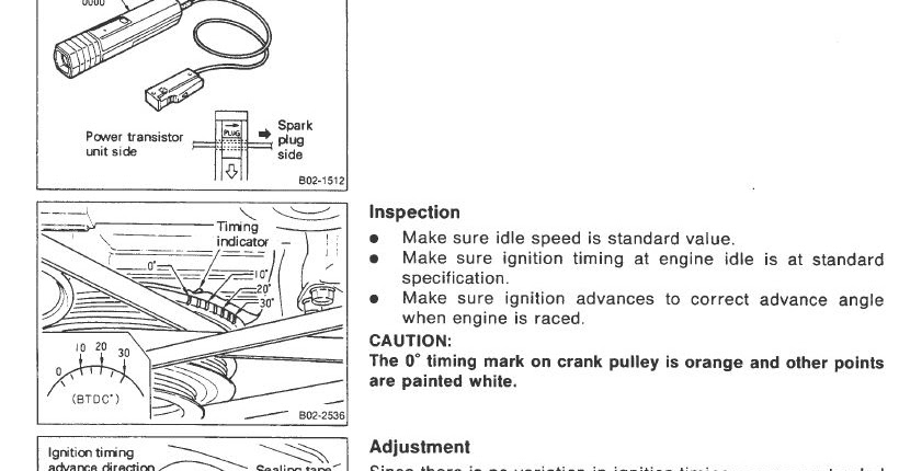

        you got spark, you got fuel, you got compression. The only variable that wont cause a running with all those is incorrect timing. Check your timing, especially because CAS was removed
        RB26DETT ignition timing guide for Nissan Skyline GT-R R32, R33, and R34. Covers base timing, crank angle sensor setup, TDC verification, and common C
