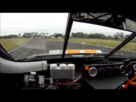

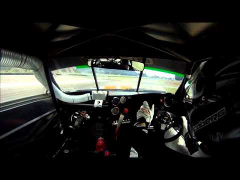

              This person runs ACL forged pistons (stock I beam conrods, stock conrods bolts) in his 550hp RB20DET powered R32 GT2 racecar (running on E85 gas and is limited by the ignition system, stock LS V8 truck coilpack conversion should fix that) -
