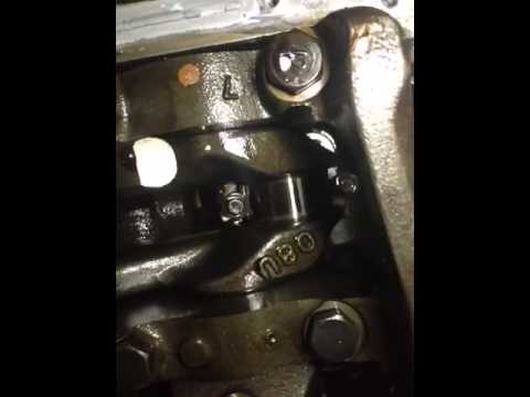

                        Ignore the talking to Steve part, that is my friend who was helping me with the noise. But here are videos of under the car with the rod caps off and the actual bearings in the house.
                        I'm thinking they look pretty good but I'll let the videos do the talking. Enjoy and let me know what you guys think.
                          Nothing wrong with that. Just clean up the journals and rods with some varsol and put your new brgings in. Leave them dry and do a quick Plasiguage check. The squashed plastic comes off pretty good with a little WD40. Not sure where the noise was coming from because the rods look good. Maybe pull off the mains if you can and take a peek...kinda hard on these motors though with the common main girdle.
