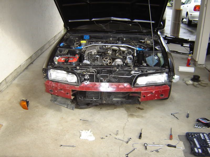

        Updates!!!!!!

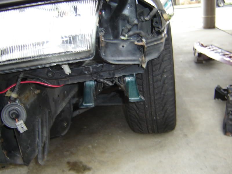

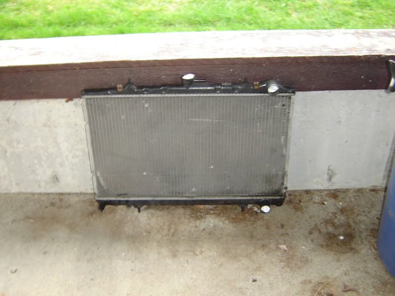

        Alrighty so I've been up to no good lately. I finally got N so I can now drive my babe around and she ends up breaking on me. Basically I have a dead coil pack in cylinder #1 so I've orderd a bunch of parts through Adam at Feast. He gave me a heads up on the 1-2 week wait for the coil packs ahead of time so I thought that while my car wasn't going to be moving anytime soon I would start to tear it apart. I orderd everything for the cooling system and the coil packs so by tearing it apart I ment preping it for the new water pump and what not.

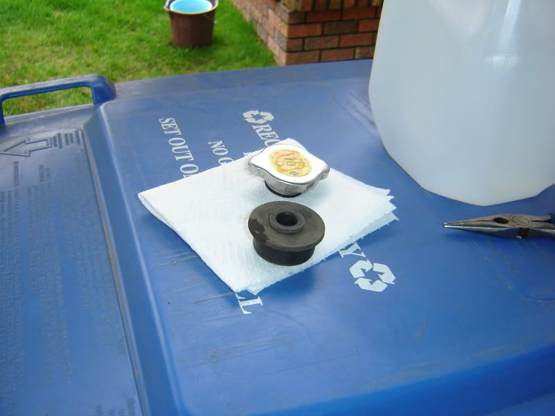

        Anyway after getting the rad out I noticed I was missing one of the bottom bushings in the rad.
        I also found out why the fan shroud was all floppy on one side, because it was cracked at the bottom.

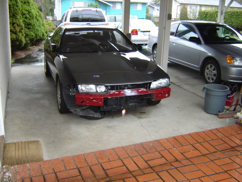

        And then things kinda went downhill from there. I'm one of those guys that cant stand doing things half-a**ed and was really sick of looking at the horns tied to the a/c fan and then the wires for the a/c fan seem to be completely cut so the fan is doing absolutly nothing other than looking pretty and it's not even doing a good job of that. I also noticed that the hood latch was not bolted down at the bottom. Instead of mounting the intercooler with both bolts (one at the bottom of the center brace and the second at the top of the center brace mounting to the bottom of the hood latch) the previous owner took the quick and lazy (no offence if/when you read this) and drilled down alittle lower. However I think he planned this out, by that I mean he mounted the intercooler lower to allow for more of the core to show in the grill creating better cooling efficency. But I removed all that so I could remount my horns somewhere a little more hidden. I've also done this to fix all of the open ended wires that are just sitting there fully exposed and to re-wire the front end.
        Sorry in advance for the blurry pics.

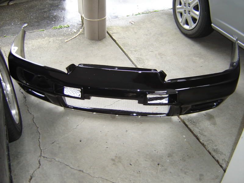

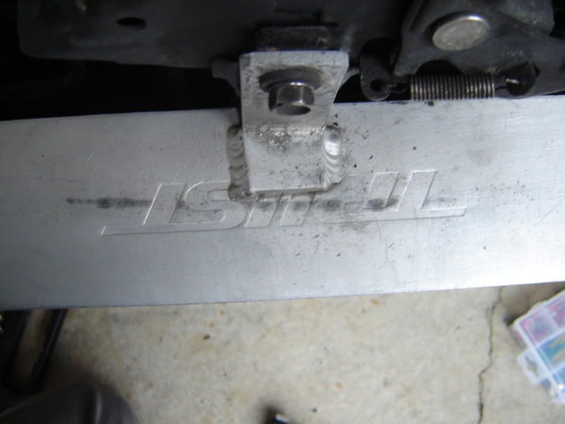

        Notice where the support was cut to allow for the N1 ducts. Due to care-less-ness it has started to rust as it was cut and the bumper was istalled over without deburring the cuts leaving a mess of a job for me to fix. I plan on removing this support and cleaning it up and painting it black to match the bumper so it doesn't stick out like a sore thumb.
        Complete with freshly whiped clean Wine red bumper support.

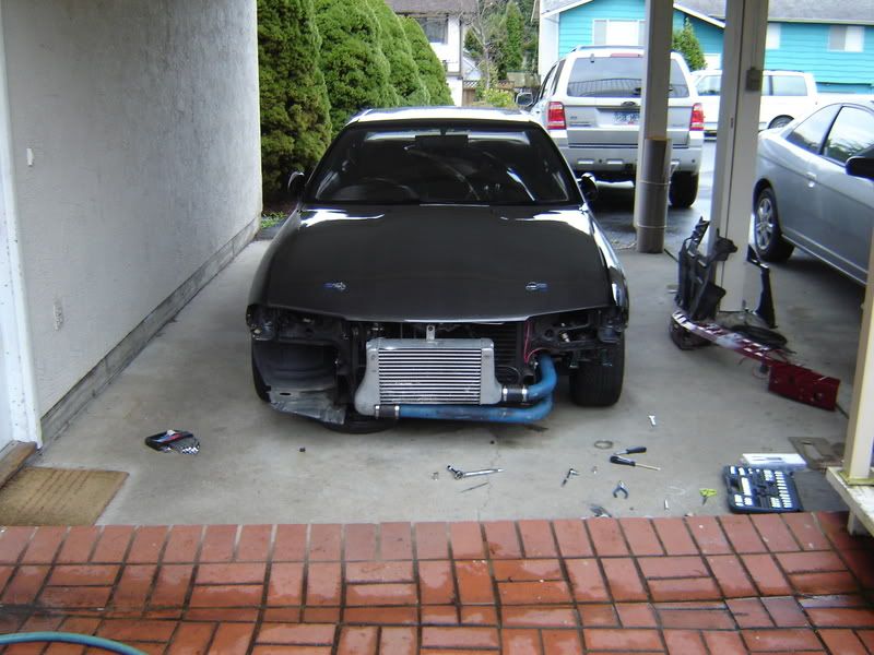

        • #34

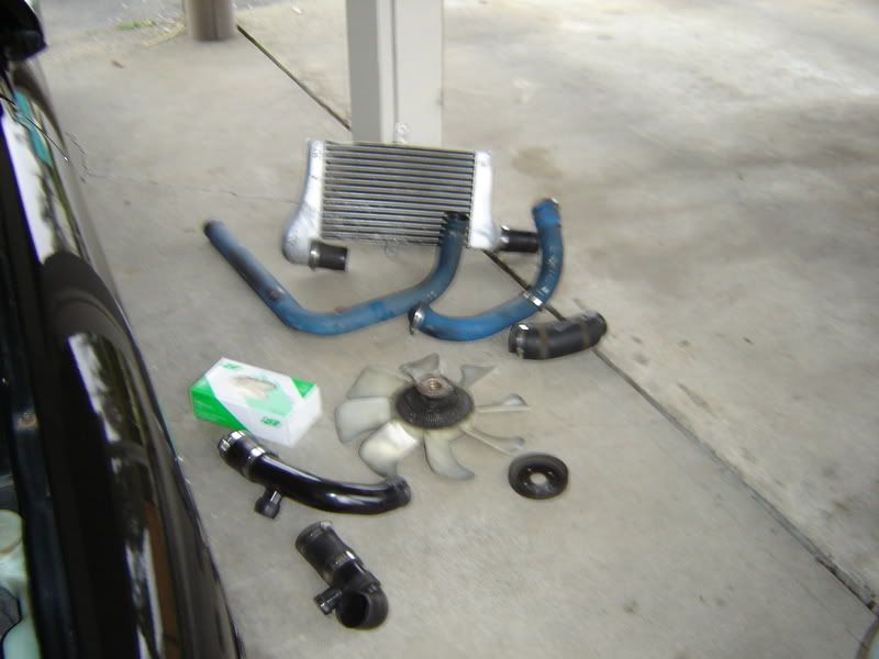

          Well did more work on my car today.
          Remounted the intercooler properly.

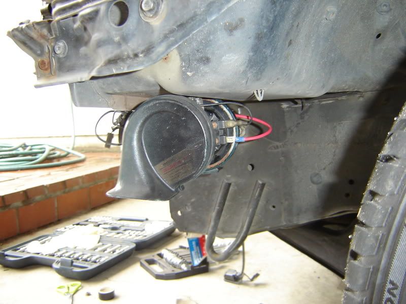

          Hide my horns with some extreme high end customizing.
          Close up of the intercooler top.
          All piping installed. I realized why the prevous owner didn't install it properly, cause it's almost impossible to get the intercooler piping on.
          And my favorite of all,

            Ryan,
            Yes I mounted it like that on purpose because it didn't used to sport such a big GTR front bumper. It used to be a GTS bumper I had removed the center support to allow air flow. It actually looked perfect on that old bumper. It had to go though when it cracked. =/ GTR bumper was cheap and easy to come by. One more thing about the intercooler, the mounting tabs were bent when I received it. It was a used intercooler =/
            Ryan the sloppy job on the rad fan shroud wasn't my doing. It didn't "flap" when I had it. Only after I received it back from getting the front bumper painted and they put it all back together.
            Yes, intercooler piping is a B**** as the piping is never quite bent properly or long enough. Once I put the piping on it didn't line up properly to the bumper etc. It was never easy :P As well when the car was returned to me you remember that the rad hoses were not tight and leaking coolant...They also didn't tighten the intercooler piping so it blew off on me on the way to work. Nice way to ruin a $70 dress shirt lying down on the side of the highway trying to fix a bad boost leak =/ God damn. Oh and the rebar thing pisses me off. I got rid of mine because it was rusted like you'd never believe, bought a brand new one and they didn't bother painting it after they plasma cut it? Sorry bro.
            As for the horns? Previous to you buying the car they weren't even installed...lol. I just put them in for you before I dropped the car off hey they worked right? :P.
            No I'm not offended. As for body work/brackets. It was never my thing. I did however pay very close attention to the mechanical workings of the car which I think matter more. Would you rather have your horns mounted properly, or a mechanically perfect car? Right I think so :P
            As for the coils I polished the insides of them, changed oil so frequently it came out clean, made sure the fuel system was top notch, cleaned out the engine, fixed all vacuum leaks, bad grounds etc. You name it, I did it. Not to mention changing all the suspension pieces in one go instead of one part.
            • #36
              Andrew,
              No worries on the intercooler tabs being bent. It's aluminum, which is a soft metal = it bends with ease. I bent it back into shape and mounted it.
              Rad was missing a bushing. Just ordered through Adam.
              Intercooler piping is a b*tch to install. Im gonna pull out my angle grinder and cut the hole open properly to allow the piping to fit with ease. As for the rebar, I'm in the work of deburring it and then going to repaint it black to match the car. Im also looking to redrill the holes and properly line up the front end. With the intercooler now mounted where it is there is a huge gap between the bumper and the intercooler. I dont mind it as long as everything lines up.
              Horns work twice as good now that I have rewired them.

                I'm not surprised the horns work better now, the wires previously looked so fragile I didn't want to touch them. Those are loud horns to begin with. I'm wondering what they sound like now lol!

                  As for the horns. Yes they do work better now. I think you had one of them wired up backwards so only one horn was working. I tested them one at a time and the first one worked but the second one didn't. So I switched the wires around and tried it again and it worked. Then I hooked the other one back up and OH BOY was it ever awesome to hear both horns echo across the neighbourhood!

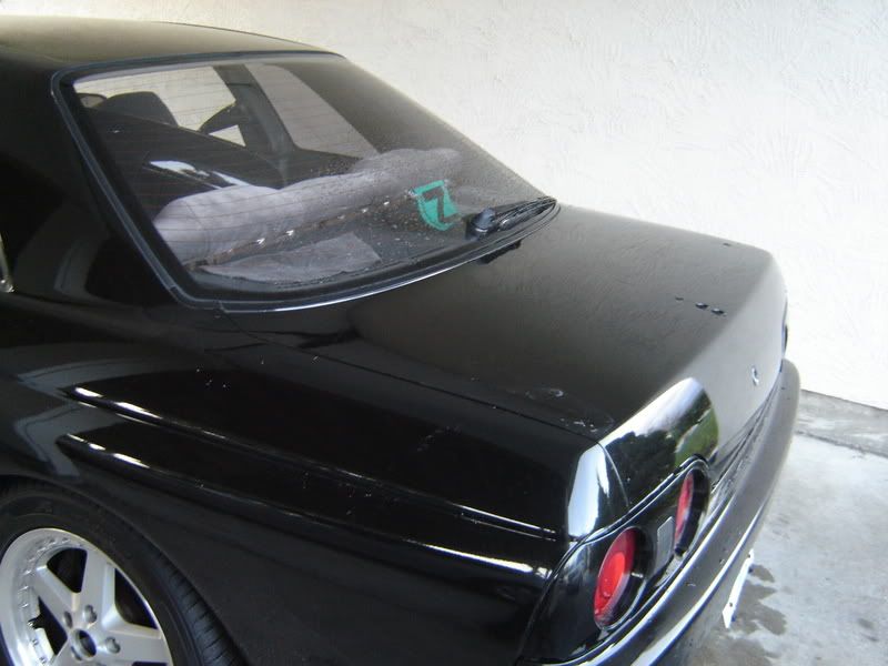

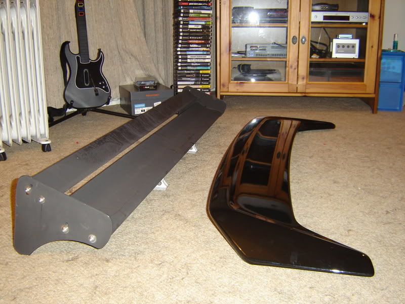

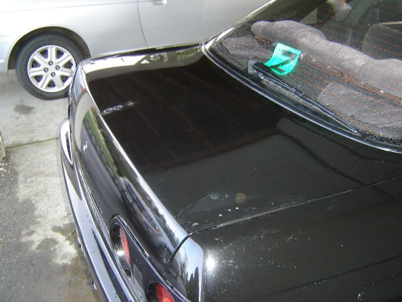

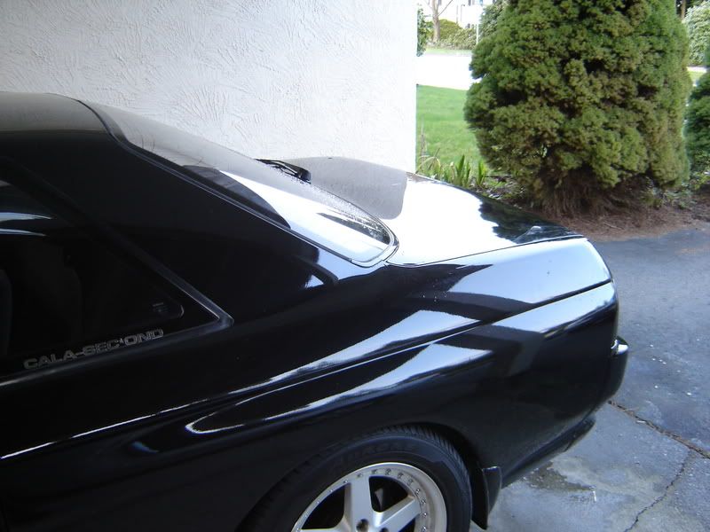

                    Removed my GTS-T Spoiler and plugged holes until I get some time to weld them closed permenently. Note car needs to be washed still.
                    And the reason why I removed it? To upgrade of course.
                    Just purchaced off of Charles,
                    I mainly bought the new spoiler for looks but once I got home and went to move my GTS-T spoiler my jaw dropped at how much lighter the low mount aluminum one was over my stock one. The GTS-T spoiler must weigh about 3 to 4 times more that the low mount. Its crazy! Thanks Again Charles

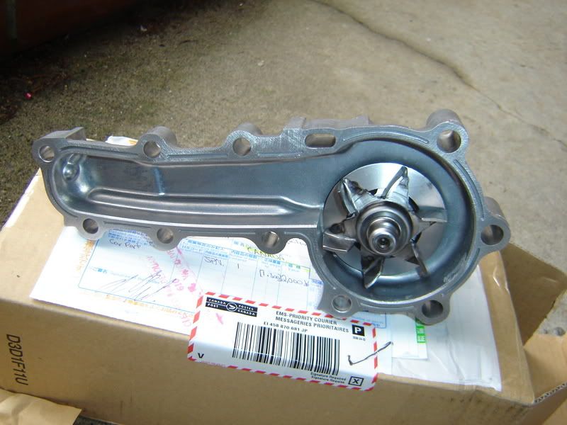

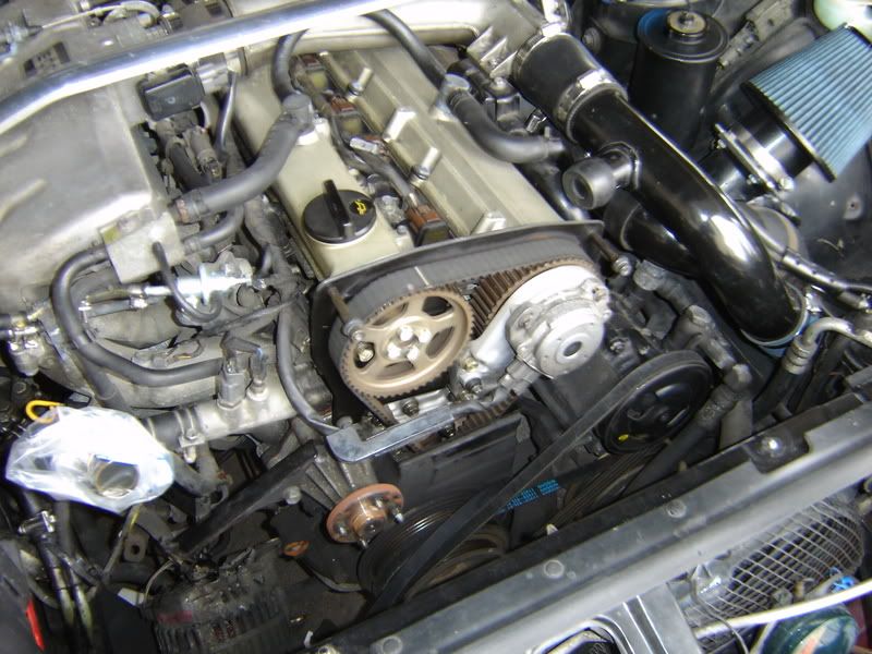

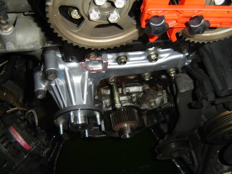

                                I got lazy and didn't post pics, here they are (better late than never, i guess)
                                N1 water pump
                                N1 water pump installed
                                Nismo timing belt
