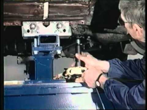

                              I noticed from a similar crash on a R32 chassis that it wasn't straight (maybe it wasn't done correctly?) when chassis was realigned. Welding a second hand front from firewall forward is probably best, easier. Also don't know if it has affected the rest of the structure behind firewall (diagonal ripple effect), popping welds, bending floor panel (thin metal), etc.
                              Probably have to check on chassis alignment machine (Car-0-Liner or similar) to measure chassis, pull on chassis until is at factory specs -
