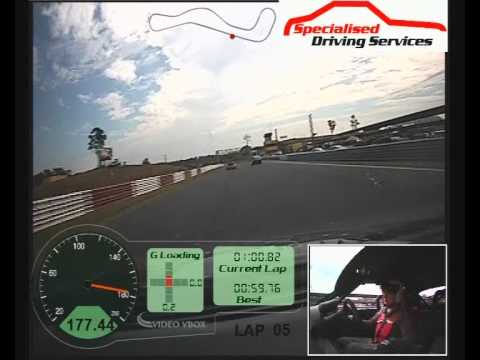

This R32 GTS-T Targa Rally car has a boosted up RB20DET (330hp at engine with 1 bar) and looks similar to your car -
It has basic rollcage, racing suspension, semi slicks and still has HICAS. The engine is boosted up with stock injectors, adjustable FPR, aftermarket fuel pump, PowerFC ECU + boost control solenoid, Z32 AFM + Z32 AFM plug/ pigtail, 3" exhaust from stock turbo, stock GTR FMIC (also clutch upgrade). Basic but works in Targa where there's a restriction on mods allowed and isn't expensive to do and fun to drive on racetrack for trackdays.
It didn't have an a engine oilcooler and the engine eventually failed (bearings) after alot of laps due to high oil temps. As long as keep oil temps under control it should last for a while.Last edited by Skym; 03-10-2015, 03:37 AM.RESPONSE MONSTER
