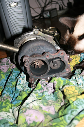

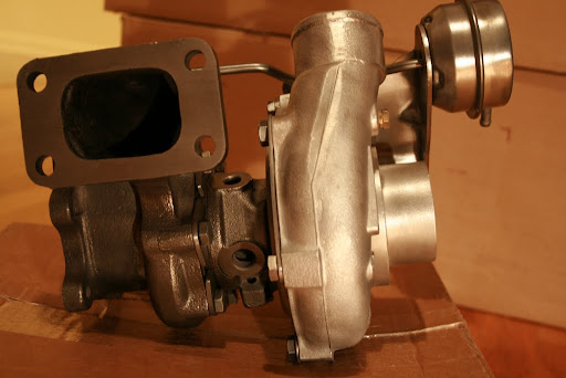

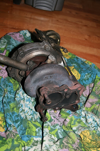

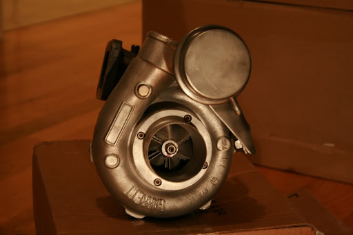

            Well I got my turbo rebuilt!
            Here are a few before and after shots
            AND AFTER!
            here's what the Blaast performance told me:
            It seems I was missing a ball, from the ball bearing, and the oil seal was done for. So mucho oil was coming in the intake manifold.
            My theory on the over boosting is that the oil fumes didn't burn in the cylinder, but probably in my exhaust manifold, which in turn did like an antilag.. providing more boost.
            Also, he ported the wastegate hole to provide more volume evac if needed.
            AND he put in ceramic ball bearings!! it seems it will bring spool down by 500RPM!!
            can't wait to see that!

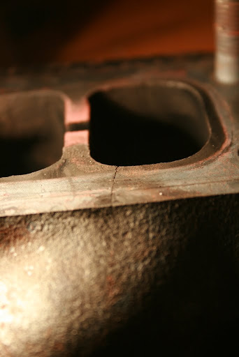

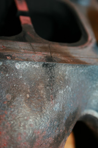

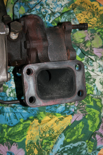

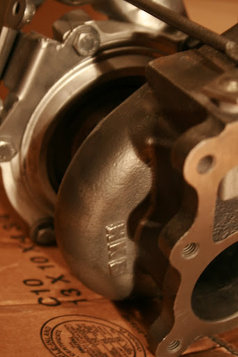

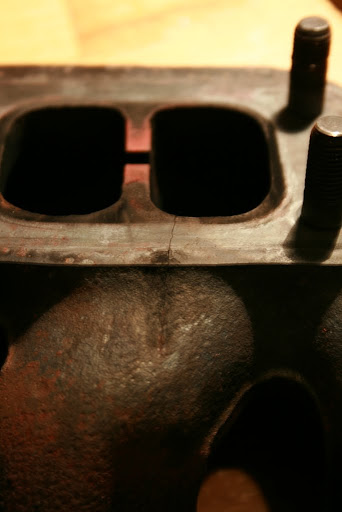

                        Well, I removed the stock GTS-T turbo, to put my rebuilt HKS back in. but first I decided to to see if the manifold and turbine inlet needed a little port to optimize the flow.
                        well two things were discovered:
                        1- yes theres a lot of beef that can be ported compared to the gasket... around 1/8 to 1/4"
                        and two this:
                        as some of you might notice it is a divided manifold... dunno if it's stock... but it was on my car.
                        but the major problem is that it as a effin crack in it!!!
                        so my inspection lead to this finding out I had a crack manifold.. the crack is about 1.5" long and is from inside to outside
                        that the good part, me finding I had a crack
                        the bad part is that 1 of the 12 exhaust studs that broke into the head > *cry*
                        (-,_,-)
                        I have a new stock manifold on the way
                        just need to order an exhaust gasket

                        • #57
                          good thing you found that crack before it led to any other (worst) problem
                          • #58
                            Enlarging ports on exhaust manifold, matching turbo to exhaust manifold (using gasket as guide) on RB25DET engine seems to make engine rev quicker, more wheelspin and can run 4 degrees less ignition timing for same rwhp and 15% less duty cycle on boost controller.
                            I hear Nismo does this to N1 exhaust manifolds on RB26, so above reasons could be why they do it. I think Mines do the same thing.
                            • #59
                              Damn, at least you noticed the crack..
                              I have a manifold if you need!! I really should bump my FS thread for my RB20 motor that's just sitting around collecting dust.. If you still need it, or want one sooner, let me know!
                              As for the gasket matching; i did that on mine before putting it back into the car.. However, as you all know, i havent really been able to test the car to its max potential as everything seems to be exploding lol.
                              There may be (might be different for you) 2 ports on the engine side of the manifold that can matched as well.. For me anyways, it was the 2 closest to the firewall.. They were off as much as 2 mm.. I also stuffed the exhaust ports and went for the matching on the head as well. Cleans up really nice, and as Skym mentioned and many others as well, there seems to be a noticeable gain in terms of power and efficiency.. I can imagine an RB20 would benefit a lot more from something like this..
