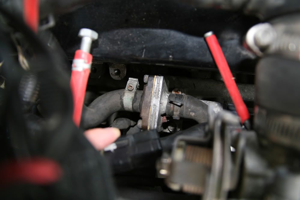

          Didn't get a chance to take the stuff apart until today. Just to confirm, this is the IACV?
            That's the IACV or cold idle valve.
