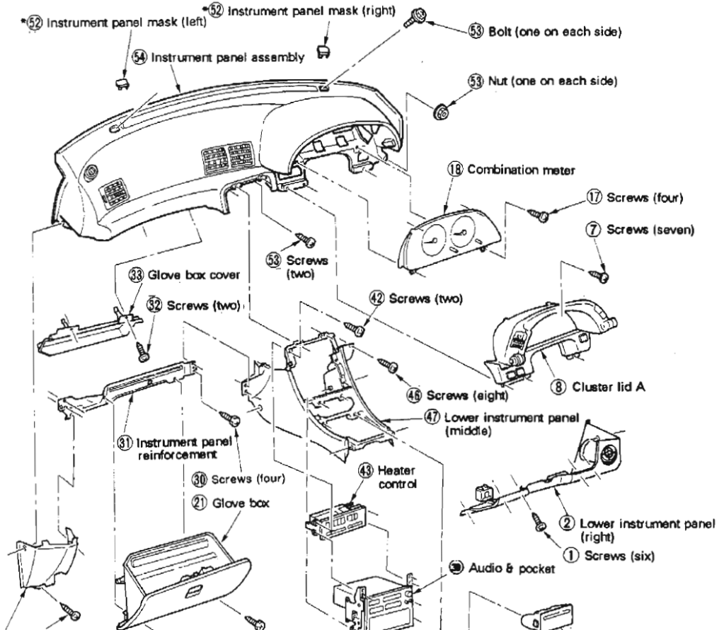

Hey, I got an R32 and want to remove the trim around the steering wheel to install a bass control knob in the blank square to the left of the wheel and a toggle to the right. The piece I need to remove is circled in red
