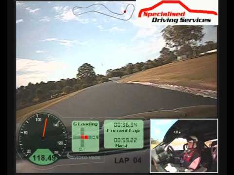

              This RB20DET (330hp at engine with stock turbo) has those specs you mentioned in post + Z32 AFM, Z32 AFM plug, Apexi PowerFC (has stock airbox), etc -
              It can pass a boosted up stock R32 GTR (limited to stock engine, stock turbo in Targa).
