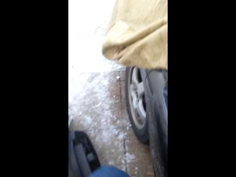

Hey i have a rb20det in my r32 gts-t. When i start the engine it has trouble staying on idle, i have to give it some gas until it decide to idle, and this is how it sound:
how ****** is my engine?
From the sound of it i would guess it need to be rebuild which lead my to my second question, Should i put another Rb20det in it or go for a rb25det
Thanks in advance!
