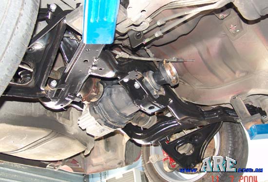

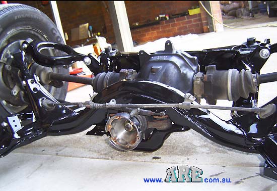

    About GTR diffhead -
    1.) I think mount hole size (diameter, location) is different on GTR diffhead (need GTR subframe that bolts in).
    Here's a GTR diffhead bolted in on a S13 (240sx? in Northern hemisphere) -
    2.) As you mentioned, input shaft is different -
    Not sure about output shaft's (usually amount of bolts, nuts to bolt half shaft's on are the difference between turbo, non turbo diffhead's). Also GTR halfshaft's are bigger in diameter (stronger).
