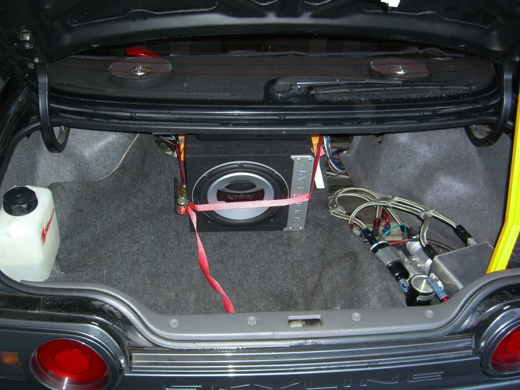

                  Pic of my trunk for whoever asked for it

                      the AEM kit is pretty simple. It will always spray unless you manually shut it down. You just set the max boost level and it'll inject a percentage of the max from no boost to max percentage at full boost.
                      Simple to install other than the injectors. Andrew at Monkey nuts has done a great job of aiming/installing the nozzles for this kit!
